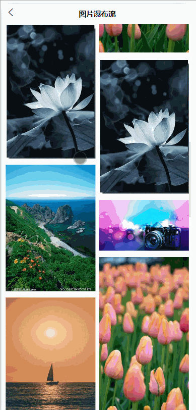

1. 图片瀑布流
不依赖任何插件,复制即可见效:
<template>
  <view class="page">
    <view class="left" ref="left">
      <image class="image" v-for="(item,i) in leftList" :key="i" :src="item" mode="widthFix"></image>
    </view>
    <view class="right" ref="right">
      <image class="image" v-for="(item,i) in rightList" :key="i" :src="item" mode="widthFix"></image>
    </view>
  </view>
</template>
<script>
  export default {
    data() {
      return
        imageList
          "https://img0.baidu.com/it/u=1345303087,1528317222&fm=253&fmt=auto&app=138&f=JPEG?w=500&h=1082"
          "https://img2.baidu.com/it/u=1893470775,4143435497&fm=253&fmt=auto&app=138&f=JPEG?w=889&h=500"
          "https://img0.baidu.com/it/u=1088754973,1390499664&fm=253&fmt=auto&app=138&f=JPEG?w=335&h=500"
          "https://img1.baidu.com/it/u=3866290852,3566512524&fm=253&fmt=auto&app=138&f=JPEG?w=800&h=500"
          "https://img2.baidu.com/it/u=1114729443,1120710416&fm=253&fmt=auto&app=138&f=JPEG?w=667&h=500"
        ], //所有图片
        leftList: [], //左边列图片
        rightList: [], //右边列图片
        leftHeight: 0
//左边列高度
        rightHeight: 0
//右边列高度
        columnWidth: 0
 //列宽度
    mounted() {
      this
.$nextTick(() => {
        uni.createselectorQuery().in(this
).select('.left').boundingClientRect(res => {
          this
.columnWidth = res.width
          //方法
          this
.setWaterFallLayout()
        }).exec()
    onReachBottom() {
      console
.log("触底");
      let
 newList = [
        "https://img1.baidu.com/it/u=833730514,666835&fm=253&fmt=auto&app=138&f=JPEG?w=355&h=500"
        "https://img1.baidu.com/it/u=3311811998,3185175032&fm=253&fmt=auto&app=138&f=JPEG?w=500&h=625"
        "https://img0.baidu.com/it/u=3319997766,4089593231&fm=253&fmt=auto&app=138&f=JPEG?w=889&h=500"
      this
.imageList.push(...newList)
      console
.log(this.imageList);
      this
.setWaterFallLayout();
    methods
      //通过uni.getImageInfo,小程序支持
      async
 setWaterFallLayout() {
        for
 (let item of this.imageList) {
          try
            let
 h = await this.getImgHeight(item)
            if
 (this.leftHeight <= this.rightHeight) {
              this
.leftList.push(item)
              this
.leftHeight += h
            } else
              this
.rightList.push(item)
              this
.rightHeight += h
          } catch
 (e) {}
      getImgHeight(url) {
        return
 new Promise((resolve, reject) => {
          uni.getImageInfo({
            src
: url,
            success
e => {
              resolve(e.height)
            fail
e => {
              reject(e)
</script>
<style lang="scss">
  .page {
    width
100%;
    display
: flex;
    align-items
: flex-start;
    padding
0 1%;
    box-sizing
: border-box;
  .left
  .right
    margin
0 auto;
    width
48%;
  .image
    width
100%;
    height
: auto;
    margin-bottom
10px;
  .info
    width
100%;
    height
200rpx;
    background-color
#55aa7f;
</style>
运行效果:

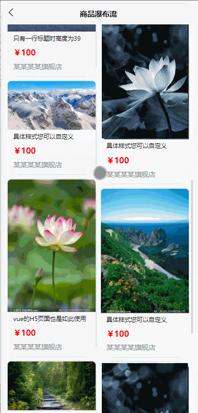

2. 商布流:
不依赖任何插件,复制即可见效:
<template>
  <view class="Index">
    <!-- 瀑布流布局列表 -->
    <view class="pubuBox">
      <view class="pubuItem">
        <view class="item-masonry" v-for="(item, index) in comList" :key="index">
          <image :src="item.img" mode="widthFix"></image>
          <view class="listtitle">
<!-- 这是没有高度的父盒子(下半部分) -->
            <view class="listtitle1">{{ item.name }}</view>
            <view class="listtitle2">
              <text class="listtitle2son">
</text>
              {{ item.commdityPrice }}
            </view>
            <view class="listtitle3">
              某某某某旗舰店
            </view>
          </view>
        </view>
      </view>
    </view>
  </view>
</template>
<script>
  export default {
    data() {
      return
        comList
"https://img2.baidu.com/it/u=3853345508,384760633&fm=253&app=120&size=w931&n=0&f=JPEG&fmt=auto?sec=1689958800&t=210689b7eb06d7c78958d7063151cba6",
            name
'商品的名称,可以很长很长很长很长很长很长很长很长很长很长很长很长很长很长很长很长很长很长',
            commdityPrice
100
'https://img2.baidu.com/it/u=1814268193,3619863984&fm=253&app=138&size=w931&n=0&f=JPEG&fmt=auto?sec=1689958800&t=d6764859a9740bb4aead7703daa61876',
            name
'商品名称会在超出两行时候自动折叠',
            commdityPrice
100
'https://img0.baidu.com/it/u=1604010673,2427861166&fm=253&app=138&size=w931&n=0&f=JPEG&fmt=auto?sec=1689958800&t=2e255208580c0570167a800344d3aa59',
            name
'只有一行标题时高度为39',
            commdityPrice
100
'https://img0.baidu.com/it/u=2627496060,1933351908&fm=253&app=138&size=w931&n=0&f=JPEG&fmt=auto?sec=1689958800&t=fd7a89ad586d338543b6916df7083e4f',
            name
'具体样式您可以自定义',
            commdityPrice
100
'https://img2.baidu.com/it/u=3853345508,384760633&fm=253&app=120&size=w931&n=0&f=JPEG&fmt=auto?sec=1689958800&t=210689b7eb06d7c78958d7063151cba6',
            name
'vueH5页面也是如此使用',
            commdityPrice
100
        ], //商品列表
    onShow() {},
    onLoad() {},
    methods
    // 触底加载下一页 换成真实的请求到的数据
    onReachBottom() {
      console
.log("触底");
      // 模拟的请求数据
      let
 newList = [
"https://img2.baidu.com/it/u=1893470775,4143435497&fm=253&fmt=auto&app=138&f=JPEG?w=889&h=500",
          name
'具体样式您可以自定义',
          commdityPrice
100
"https://img0.baidu.com/it/u=1088754973,1390499664&fm=253&fmt=auto&app=138&f=JPEG?w=335&h=500",
          name
'具体样式您可以自定义',
          commdityPrice
100
"https://img1.baidu.com/it/u=833730514,666835&fm=253&fmt=auto&app=138&f=JPEG?w=355&h=500",
          name
'具体样式您可以自定义',
          commdityPrice
100
          name
'具体样式您可以自定义',
          commdityPrice
100
      this
.comList.push(...newList)
      console
.log(this.comList);
</script>
<style scoped="scoped" lang="scss">
  //瀑布流
  page {
    background-color: #eee;
    height: 100%;
  .pubuBox {
    padding: 22rpx;
  .pubuItem {
    column-count: 2;
    column-gap: 20rpx;
  .item-masonry {
    box-sizing: border-box;
    border-radius: 15rpx;
    overflow: hidden;
    background-color: #fff;
    break-inside: avoid;
避免在元素内部插入分页符*/
    margin-bottom: 20rpx;
    box-shadow: 0px 0px 28rpx 1rpx rgba(78, 101, 153, 0.14);
  .item-masonry image {
    width: 100%;
  .listtitle {
    padding-left: 22rpx;
    font-size: 24rpx;
    padding-bottom: 22rpx;
    .listtitle1 {
      line-height: 39rpx;
      text-overflow: -o-ellipsis-lastline;
      overflow: hidden;
      text-overflow: ellipsis;
      display: -webkit-box;
      -webkit-line-clamp: 2;
      line-clamp: 2;
      -webkit-box-orient: vertical;
      min-height: 39rpx;
      max-height: 78rpx;
    .listtitle2 {
      color: #ff0000;
      font-size: 32rpx;
      line-height: 32rpx;
      font-weight: bold;
      padding-top: 22rpx;
      .listtitle2son {
        font-size: 32rpx;
    .listtitle3 {
      font-size: 28rpx;
      color: #909399;
      line-height: 32rpx;
      padding-top: 22rpx;
  .Index {
    width: 100%;
    height: 100%;
</style>
运行效果:
