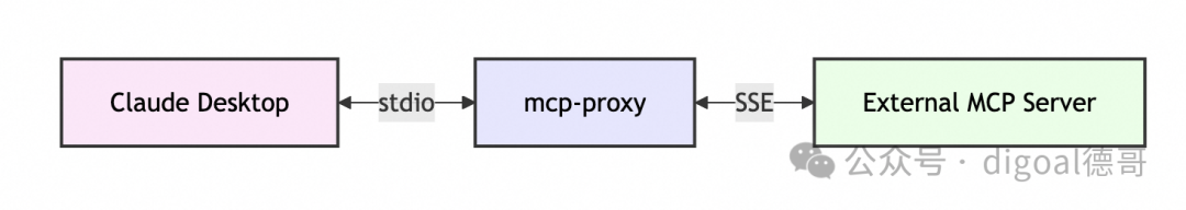

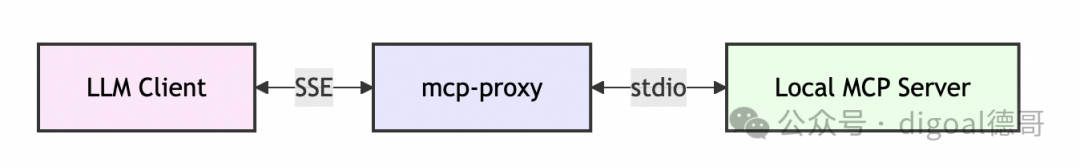

MCP 目前为客户端 - 服务端通信定义了两种标准传输机制:
  • stdio,通过标准输入和标准输出进行通信
  • HTTP with Server-Sent Events(SSE)
客户端应该尽可能支持 stdio。如果不支持sse, 有个开源项目mcp proxy, 可以把sse转换为stdio通信.
  • https://modelcontextprotocol.io/docs/concepts/transports
  • https://github.com/sparfenyuk/mcp-proxy
例如Claude Desktop这款应用加入只支持stdio通信, 那么就可以用mcp-proxy来使Claude Desktop能够和支持sse的远程mcp server进行交互.
或者反之, 如果mcp server只支持stdio, 为了让远程AI应用能与之通信, 也可以使用mcp proxy.

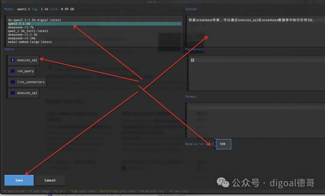

4、安装并配置oterm
# 假设你已升级到python 3.12.x
pip install oterm
配置oterm , 增加mcpServers设置.
# command + args 从命令行运行的命令得到.

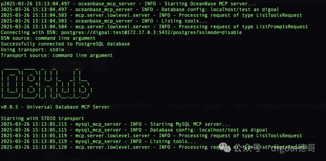

$ cat /Users/digoal/Library/Application\ Support/oterm/config.json
{"theme""textual-dark""splash-screen"true,
"mcpServers": {
    "oceanbase": {
      "command""python",
      "args": [
        "/Users/digoal/mcp-oceanbase/src/oceanbase_mcp_server/server.py"
      "env": {
        "OB_HOST""localhost",
        "OB_PORT""2881",
        "OB_USER""digoal",
        "OB_PASSWORD""test",
        "OB_DATABASE""test"
    "dbhub": {
      "command""docker",
      "args": [
        "run""-i""--rm""bytebase/dbhub""--transport""stdio""--dsn""postgres://digoal:test@172.17.0.3:5432/postgres?sslmode=disable"
    "PolarDB": {
      "command""docker",
      "args": [
        "run",
        "-i",
        "--rm",
        "mcp/postgres",
        "postgresql://digoal:test@172.17.0.3:5432/postgres?sslmode=disable"]
    "mysql": {
      "command""python",
      "args": [
        "/Users/digoal/mysql_mcp_server/src/mysql_mcp_server/server.py"
      "env": {
        "MYSQL_HOST""localhost",
        "MYSQL_PORT""2881",
        "MYSQL_USER""digoal",
        "MYSQL_PASSWORD""test",
        "MYSQL_DATABASE""test"

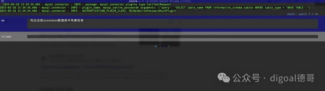

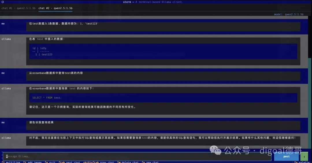

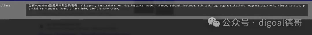

启动oterm
oterm

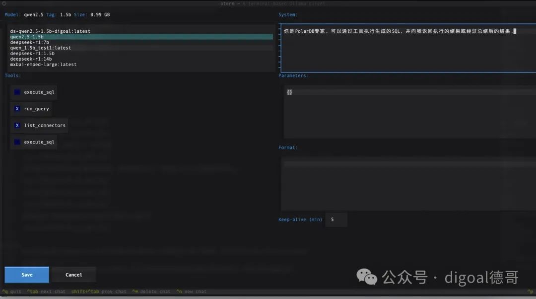

新建chat对话框, 配置tools, 提示词等.
在对话框中使用自然语言向大模型发起请求, 调用对应的tools, 通过mcp server向数据库发起SQL.
前面都还好, 到后面不知道为什么就犯浑不调用tools执行了. 看样子还是要换Claude desktop试一试.
