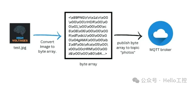

使用 MQTT 协议发布图像
使用 MQTT 协议发布图像是一种非常直接的方法。下面的图像解释了我们在本期中将要使用的流程。
Step1:首先我们需要在 Python 中读取我们的图像文件或其他类型的文件。
with open("./test.jpg",'rb'as file:    filecontent = file.read()
Step2:读取文件后,我们将图片转换为字节数组然后我们将字节数组发布到我们想要发送图片的主题。
    byteArr = bytearray(filecontent)
Step3:在这种情况下,我们使用以下代码将图片发送到名为 photos 的主题。
    result = client.publish(topic,byteArr,2)msg_status = result[0]if msg_status == 0:    print(f"message : Message sent to topic {topic}")else:    print(f"Failed to send message to topic {topic}")
字节数组将发布到主题。以下是一段完整的代码,它将帮助您使用 mqtt 协议在 python 编程语言中发布任何图片:
import timefrom paho.mqtt import client as mqtt_clientbroker = 'broker.hivemq.com'port = 1883topic = "photos"client_id = 'your client id'def connect_mqtt():    def on_connect(client, userdata, flags, rc):        if rc == 0:            print("Successfully connected to MQTT broker")        else:            print("Failed to connect, return code %d", rc)    client = mqtt_client.Client(client_id)    client.on_connect = on_connect    client.connect(broker, port)    return clientdef publish(client):    with open("./test.jpg",'rb'as file:        filecontent = file.read()        byteArr = bytearray(filecontent)        print(byteArr)        result = client.publish(topic,byteArr,2)    msg_status = result[0]    if msg_status == 0:        print(f"message sent to topic {topic}")    else:        print(f"Failed to send message to topic {topic}")def main():    client = connect_mqtt()    client.loop_start()    publish(client)    time.sleep(5)    client.loop_stop()if __name__ == '__main__':    main()
